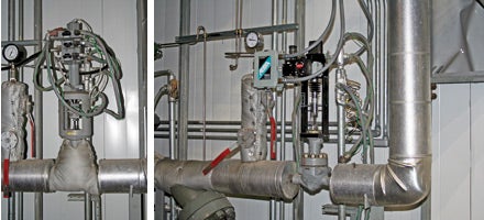

4. IP attemperator retrofit.
Retrofit of a conventional hydraulic system actuator (top) to an Electraulic actuator (bottom) on the IP attemperator of a typical combined-cycle plant. Courtesy: Koso America Inc.

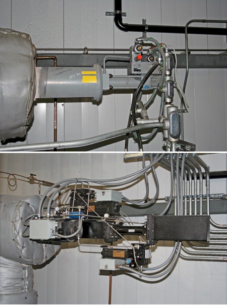

5. IP bypass retrofit.
Retrofit of a conventional hydraulic system actuator (top) to an Electraulic actuator (bottom) in the IP bypass line. Courtesy: Koso America Inc.

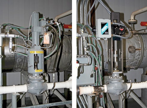

6. HP attemperator retrofit. Retrofit of a conventional hydraulic system actuator (left) to an Electraulic actuator (right) on the HP attemperator of a typical combined-cycle plant. Courtesy: Koso America Inc.

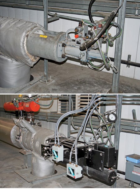

7. HP bypass retrofit. Retrofit of a conventional hydraulic system actuator (top) to an Electraulic actuator (bottom) in the HP bypass line. Courtesy: Koso America Inc.
