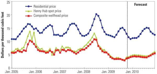

The supply optimism is good news for existing and potential electric generators, as the projections, bolstered by successful drilling in shale, have resulted in dramatically lower natural gas prices. The most recent reports from the EIA found natural gas prices at the Henry Hub at $2.76 per million Btu (mmBtu). Futures prices at the New York Mercantile Exchange for September 2009 contracts were at $2.91 per mmBtu. A couple of years ago, the NYMEX price was in the $9 range for short forward contracts (Figure 1).
1. Gas prices expected to stabilize in 2010. The U.S. Energy Information Administration (EIA) predicts natural gas prices will fluctuate less and be more predictable in the future given the significant increase in gas reserves. Source: EIA November 2009 Short-Term Energy Outlook
