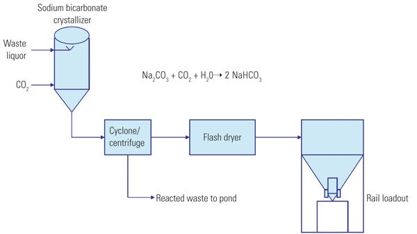

5. Economical reclamation process. This diagram shows the patent-pending process for manufacturing SOLVAir Select 300. The innovative process remanufactures a waste stream by economically recovering sodium carbonate and transforming it into a market-grade sodium bicarbonate product used to control air emissions. Source: Solvay Chemicals Inc.
