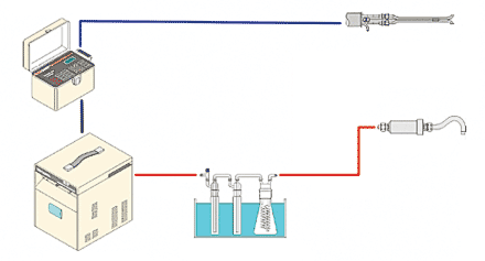

This European standard specifies a manual reference method for determining HgT concentration in the flue gas of a power plant stack. Similar to the U.S. RM, a specific-volume sample of the flue gas stream is extracted isokinetically from a stack over a certain period of time at a controlled flow rate. Particulate matter in the sampled gas stream is collected on a filter. The particle-free flue gas stream passes through a series of impingers (absorbers), which contain solution(s) for collecting gas-phase Hg. At the end of the sampling period, the filter and impinger solutions are analyzed in a laboratory.
The sampling equipment consists of a heated probe and a sampling nozzle made of titanium, a filter housing, a series of impingers, a suction unit with a gas metering device, and a flow controller. Depending on the type of impingers used, two different sampling arrangements may be employed: main stream and side stream. In the main stream arrangement, shown in Figure 9, all sampled flue gas flows through the impingers, while in the side stream arrangement only some of the flue gas is passed through the impingers. Depending on the arrangement, one or two suction units may be used.
9. Gently down the stream. A schematic of the EU sampling train with the main stream arrangement. Source: Lehigh University Energy Research Center
