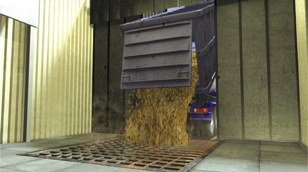

2 Receive the fuel. As a retrofit project, there were demanding construction challenges and constraints due to the existing plant’s footprint. These challenges were overcome by installing the road unloading, storage, and process works in a coal stockyard away from the boiler building. The road unloading area receives around 250 mt/h of biomass, which is unloaded by five or six trucks. Courtesy: Alstom Power

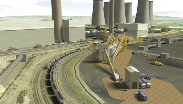

3. Unload the fuel. The biomass is transported from the road unloading building via an enclosed conveyor system that uses an air cushion to reduce fuel agitation and contain dust emissions. Courtesy: Alstom Power

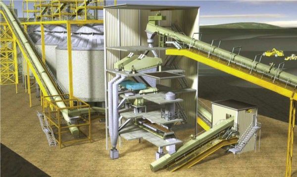

4. Process the fuel. The biomass fuel then enters a processing facility, where a series of processes including agitation and magnetic separation are used to separate out any metallic objects or stones from the biomass. At the processing facility, a sample of the biomass is taken for testing using a sampling system. Courtesy: Alstom Power

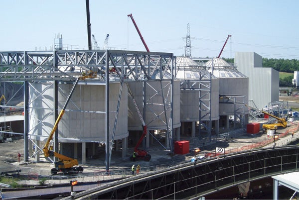

5. Convey the fuel. The biomass is then transported by conveyor from the process facility to four bulk storage silos, each with a capacity of 3,000 m3. Courtesy: Alstom Power

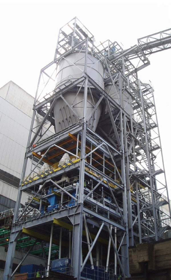

6. Store the fuel. From the bulk storage silos, the biomass is transported across the power plant to three smaller (day) silos, located just outside of the boiler building. This methodology ensures minimal disruption to the plant’s day-to-day operations. Each of these day silos can store enough fuel for two of the plant’s six units. Courtesy: Alstom Power

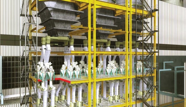

7. Grind and fire the fuel. The final processing and milling follows when the biomass is fed to a series of hammer mills that grind it into a fine powder. An air knife blower is used to remove any remaining particulates and contaminates. The biomass is then fed into an existing pulverized fuel line, where it is mixed with coal and fed to the burners of each boiler. Due to the wall-fired design of the boilers at Drax, no modifications are needed to the existing burners, which reduced the capital cost of the project. Courtesy: Alstom Power
