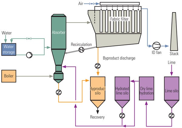

3. CFB dry scrubbing system schematic. Courtesy: Nooter/Eriksen

CFB FGD processes are substantially different than processes using SDA absorbers (Figure 4). CFB absorbers are upflow reactors, wherein all reactants (SO2, SO3, lime, and water) are introduced at the bottom of the absorber vessel along with a large portion of particulate solids collected from the downstream particulate collection device. They need no external lime preparation system requiring slakers, grit screens, pumps, and associated slurry system piping. Rather, dry hydrated lime, Ca(OH)2, is injected into the CFB absorber independently of the water and recirculated particulate.

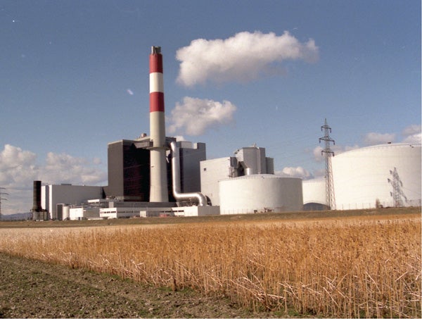

4. Gaining market share. A CFB dry scrubbing system is operating at the 300-MW Theiss Power Station located in Austria. There are approximately 17 CFB dry scrubber installations in Europe operating at coal-fired power plants. Source: Nooter/Eriksen
Through multiple venturis, flue gas is introduced beneath the bed of sorbent and particulate solids and distributed across the full diameter of the CFB absorber vessel. Single-phase mechanical water injection nozzles, located on the perimeter of the absorber and above the introduction point of the recirculated and sorbent solids, spray an atomized cloud of water droplets into the bed of solids fluidized by the incoming flue gas.
CFB technology affords an enhanced heat transfer rate within the bed by spreading the water spray over a much larger surface area of solids. The ratio of solids to spray water is in the range of 20:1, translating into an approximate 20-fold increase in surface area as compared to an SDA absorber. Rather than relying on the filter cake in the downstream fabric filter for added residence time, gases entering the CFB absorber spend about 5 seconds passing through a fluidized bed some 75 feet in depth, churning within the confines of the vessel walls. The added residence time afforded by a tall, narrow CFB absorber vessel translates into improved SO2 removal efficiencies within a small FGD system footprint.

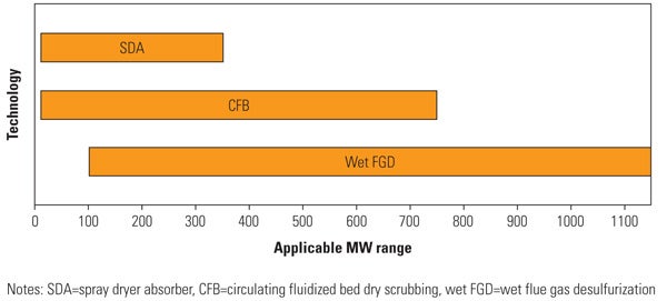

Though the choice of an SDA, CFB, or wet FGD system ultimately comes down to site-specific parameters and preferences, the application of CFB processes continues to broaden, covering the entire range of SDA processes and a larger portion of wet FGD processes (Figure 5).
5. Comparing stats. This chart shows capacity ranges for dry and wet FGD processes compared to the CFB dry scrubber when using a single absorber vessel. The technology bridge conditions afforded by CFB technologies reflect capacity limits for single absorber vessels, capital costs, labor and maintenance costs, unit availability, and SO2 removal efficiencies. Maximum CFB single scrubber limit will vary by supplier. Source: Nooter/Eriksen
Major considerations beyond the unit capacity and SO2 removal performance include the system footprint, system availability, particulate collection efficiency, ease of system erection, maintainability, and auxiliary power consumption. For each of these added considerations, CFB dry scrubbing can provide distinct and quantifiable advantages over competitive dry and wet FGD processes.
