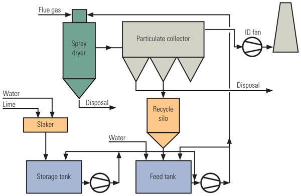

In the typical SDA system, the reagent slurry is pumped to the top of the SDA absorber vessel and introduced through one or more high-speed (11,000 rpm) spinning wheels within rotary atomizers located on the roof of the vessel (Figure 1). The atomizer(s) are centrally located within flue gas dispersers. As flue gas is accelerated and dispersed evenly around the perimeter of the spinning wheel, the pollutants are brought into intimate contact with a spray cloud of atomized droplets containing the sorbent. The sorbent reacts with SO2 and SO3 to form calcium sulfite and calcium sulfate while simultaneous cooling of the flue gas occurs. The flue gas then exits the absorber and is directed to a particulate collection device, either a fabric filter or electrostatic precipitator.
1. Typical SDA dry scrubbing system schematic. Source: Nooter/Eriksen
SDA absorbers are downflow reactors, with the atomizers and gas dispersers located on the roof of the vessel. The absorber design is limited by two basic parameters: capacity of the rotary atomizer(s) and dispersion of the flue gas. As SDA absorbers are applied to increasingly larger gas flow rates, the energy of the gas as it is compressed and accelerated through the disperser will overwhelm and imbalance the spray cloud of atomized droplets. One SDA absorber design splits the gas flow into a roof disperser and a centrally mounted disperser to balance the spray cloud from above and below. Another absorber design incorporates three roof-mounted gas dispersers to avoid any need to balance the spray cloud.
