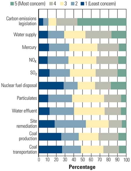

As in 2008, the 2009 Black & Veatch survey respondents ranked carbon emissions and water supply as the first and second top environmental concerns. This year, mercury replaced nitrogen oxides as number three (Figure 8).
8. Survey results: environment.
Environmental concerns are near the top the list of problems causing anxiety in utility executives. A rating of 5 indicates a very important concern; a rating of 1 is for an issue of only average concern. Source: Black & Veatch’s 2009 Strategic Directions in the Electric Utility Industry survey
