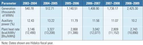

The entire plant workforce is grouped into 18 separate cross-functional teams that look for ways to reduce waste, improve maintenance processes, and improve the plant operating efficiency (table). Several significant improvement projects were recently completed that continue to push auxiliary power usage down at Hirakud Power. A sampling of these projects follows.
Cut your losses. Hirakud Power has almost quintupled production in the past five years while also significantly reducing plant auxiliary power losses. Source: Hirakud Power
