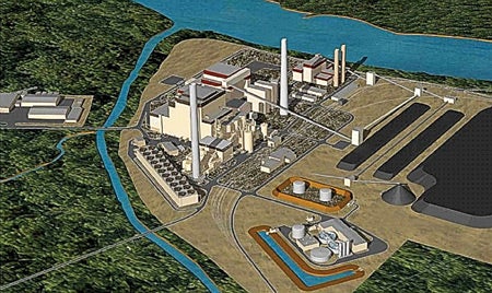

Sargent & Lundy (S&L, www.sargentlundy.com) used its 3-D modeling system, PLADES, for the detailed design of the unit. S&L integrated equipment models from all of the major equipment vendors to develop the overall plant model. The model (Figure 8) served as the primary tool for walkthroughs, constructability reviews, interference checking, and intercompany communications. Burns & McDonnell (www.burnsmcd.com) served as the owner's engineer.
8. Virtual engineering. Sargent & Lundy used 3-D modeling tools to develop an overall plant computer model, which was used for constructability studies. Source: Hitachi America Ltd.

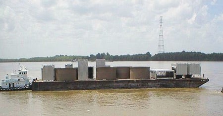

Structural steel and ductwork delivery began in May 2004, using a temporary barge unloading facility (Figure 9) built on the Missouri River. It enabled modular shipments, including box sections of boiler ductwork. Boiler components began arriving in October 2004. The steam turbine and generator also were delivered via the Missouri River in May 2005; they were placed on their foundations by August.
9. Barging in. Many large components were delivered by barge to the plant site. Source: Hitachi America Ltd.

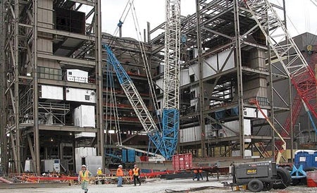

Other advanced construction practices that Hitachi has pioneered—originally for boiling-water reaactors—are prefabricating large components and simulating erection of structures and components (see "Transfer ABWR construction techniques to U.S. shores," POWER, May 2007). Both techniques were applied on this project (Figure 10). Hitachi calls its process "simultaneous erection" of all boiler-related components such as ductwork, piping, and other items along with the structural steel. The process reduced installation time by eliminating the time-intensive placement of components after the steel was erected.
10. Parallel processing. Hitachi has perfected simultaneous erection of structural steel and boiler components. The technique shortens construction schedules. Courtesy: Hitachi America Ltd.

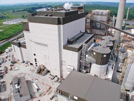

For example, note in Figure 11 that Unit 4's air quality control equipment had to be oriented perpendicular to the boiler because of the locations of existing coal-handling facilities and because the water treatment plant is located within the track loop for coal unit trains. Construction access to these areas had to be coordinated with deliveries of coal to WSEC Units 1, 2, and 3.
11. Hang a right. Note that the air quality control systems had to be installed perpendicular to the boiler building to avoid interfering with other systems and the train tracks. Courtesy: Hitachi America Ltd.
