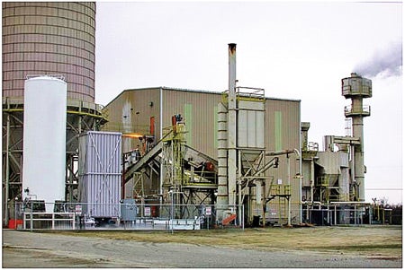

The Kimberlina facility (Figure 3) will provide the range of test and demonstration opportunities needed to facilitate commercialization of the CES technology and other oxy-fuel combustion systems. It is being developed in stages. Early on, Kimberlina served as a test facility for evaluating the durability and reliability of the oxy-combustor and to define the system design refinements called for by the CEC program (Figure 4). In the existing system, the turbine (Figure 5) is fed a mixture of 90% steam and 10% CO2. Its exhaust is routed to a geothermal-type condenser (Figure 6), which turns the steam to water and separates out the CO2.
3. Born again. CES purchased the idled Kimberlina biomass power plant and is using it to host an evaluation of its combustor's durability. Courtesy: Clean Energy Systems Inc.

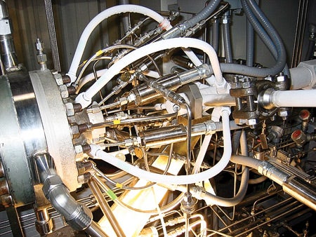

4. Maiden voyage.
The combustor's injection manifold is mounted on the 20-MW gas generator and fully connected to fuel, oxygen, and water piping on the test stand during the first operational run at Kimberlina. Courtesy: Clean Energy Systems Inc.

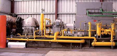

5. Alternatively fueled. The 5.7-MW gas generator/turbo-generator used at the Kimberlina test facility was built by Elliott Co. (www.elliott-turbo.com). The turbine is powered by a mixture of 90% steam and 10% CO2. Courtesy: Clean Energy Systems Inc.

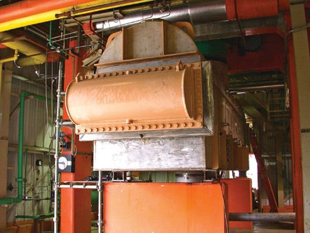

6. Binary by-product. The steam turbine exhaust goes into a condenser that separates it into water and CO2. Courtesy: Clean Energy Systems Inc.
