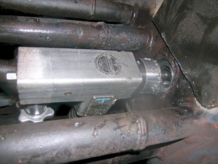

A 1/8-inch reinforcement cap was applied over the section of the header surrounding the two tube bore openings that were weld-repaired. The two tube bores then were machined in place, and new tube stub-to-header sockets were machined (Figure 6) to facilitate reinstallation of the tube stubs. Figure 7 is a sketch of the machined joints. Care was taken to properly align the new bore openings with the remaining tube stubs.
6. Precision bore. Two tube bores were precision-machined for the new tube-to-header connections. Courtesy: Thielsch Engineering Inc.
