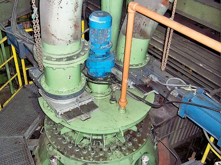

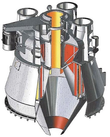

A dynamic classifier is retrofitted to a vertical-shaft pulverizer by installing a duplicate upper pulverizer casing that houses the classifier's fixed and rotating vanes, motor, and drive connections. A typical dynamic classifier assembly has a center coal feed pipe and several coal outlet pipes (Figure 6). The rotor drive is mounted on the side of the casing and driven by a belt. If the coal feed is off-center, the drive can be directly coupled, as was the case at the J.B. Sims Power Plant in Michigan (Figure 7).
6. Aftermarket leader. This is a typical LSKS dynamic classifier, with a central coal inlet pipe and four coal outlet pipes. Courtesy: Loesche Energy Systems
7. Nice installation. At the J.B. Sims Power Plant in Grand Haven, Mich., retrofitting each of three LSKS dynamic classifiers required mounting a direct drive for it in the center of the existing Model EL 56 pulverizer. Courtesy: Loesche Energy Systems

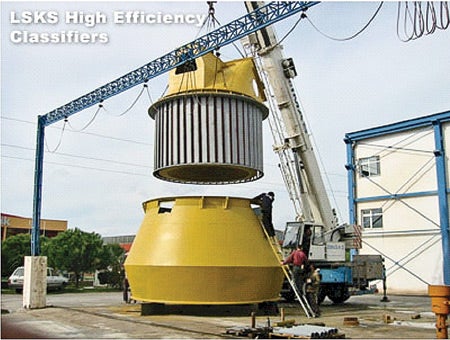

In most cases, dynamic classifiers can be installed as "slide-in" retrofits with little need to move existing equipment. Figure 8 shows another type of dynamic classifier, with one inlet and outlet, favored by the cement industry.
8. Top of the mark. This large LSKS dynamic classifier with one inlet and one outlet is being assembled prior to delivery to a cement plant. Courtesy: Loesche Energy Systems
