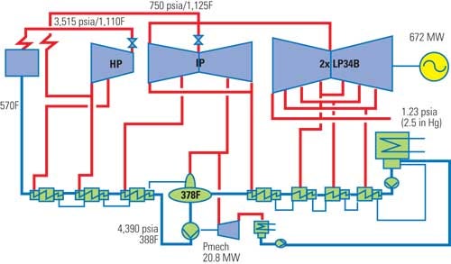

TPP was designed with eight heaters to raise the final feedwater temperature to improve efficiency as compared with a traditional subcritical unit utilizing six to seven heaters (Figure 3). Also, a heater above the reheat pressure (HARP cycle) is used. Downstream, four stages of low-pressure condensate heaters, one deaerator, and three stages of high-pressure feedwater heaters are used. An extraction from the HP turbine steam path feeds the top heater.
3.    Eight is enough. The TPP steam cycle uses eight feedwater heaters in a HARP configuration. The optimized steam cycle is shown with data taken from the average conditions for the heat rate guarantee. Source: Alstom
The HARP cycle has one big advantage: Its design allows optimization of the final feedwater temperature independent of the reheater pressure while reducing moisture at the LP exhaust. At TPP, a final feedwater temperature of 570F was chosen to optimize performance while maintaining boiler operating constraints.
TPP’s optimized steam cycle heat rate guarantee is based on 20% summer, 20% winter, and 60% annual average operating conditions. The condenser pressure on the cycle diagram (Figure 2) represents the average condition for the heat rate guarantee. In addition, the TPP cycle uses a 100% single-flow boiler feed pump turbine that is fully integrated into the main steam turbine systems. The entire steam turbine system is controlled by an Alstom digital control system.

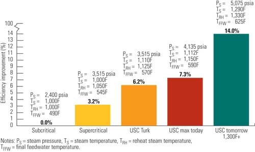

Due to the elevated steam parameters and increased final feedwater temperature, the 672-MW gross TPP plant will be about 6.2% higher in efficiency than a new-build subcritical unit of comparable power rating. This increased efficiency equates to a reduction of more than 300,000 metric tons of CO 2 per year and about 10 million metric tons of CO 2 over a 30-year lifetime compared to a new-build subcritical steam turbine unit. A comparison of various cycle parameters based on Alstom cycle calculations is illustrated in Figure 4.
4.    Reducing CO2 emissions. Ultrasupercritical steam conditions will increase the TPP plant’s efficiency by approximately 6.2% and reduce CO2 emissions by more than 300,000 metric tons per year over a conventional subcritical steam plant design. Source: Alstom
