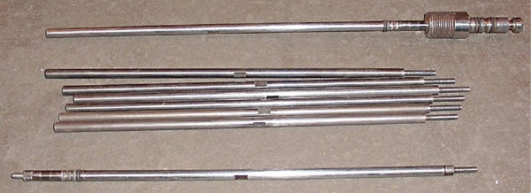

“At Tanner’s Creek the tube defects were roughly up to 6 feet back behind the tube sheet,” says APS Sales and Services Engineer David Grimes. “Instead of plugging the problem tubes, we went in with sleeves that were roughly 7 feet long and installed the sleeves in the inside diameter [ID] of the tubes and the sleeves extended past the area where the stress cracking or excessive wall loss was located. So, if the tubes continued to weaken and fail, then we have those liners installed that should prevent the tubes with through wall cracks from leaking.”

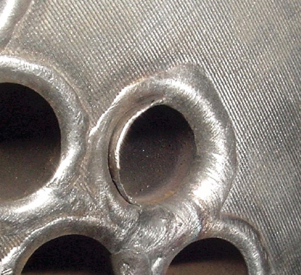

In installing the sleeves, APS employed an advanced hydraulic expansion method that utilized a flexible hydraulic expansion mandrel (Figure 3). The use of a hydraulic expander provides more uniform expansion and superior contact of the sleeve outside diameter with the ID of the parent tube. Additionally, the sleeves were strength-welded to the parent tubes at the face of the outlet tubesheet.
3. Sleeve the heater tubes. Instead of plugging the tubes, APS went in with sleeves that were roughly 7 feet long and installed in the tube inside diameter. The sleeves extended past the area where the stress cracking or excessive wall loss was located. Courtesy: American Power Services

4. Weld the tube ends. The hydraulic expander provides more uniform expansion and superior contact of the sleeve outside diameter with the inside diameter of the parent tube. Additionally, the sleeves were welded to the parent tubes at the face of the outlet tubesheet for added strength. Courtesy: American Power Services
