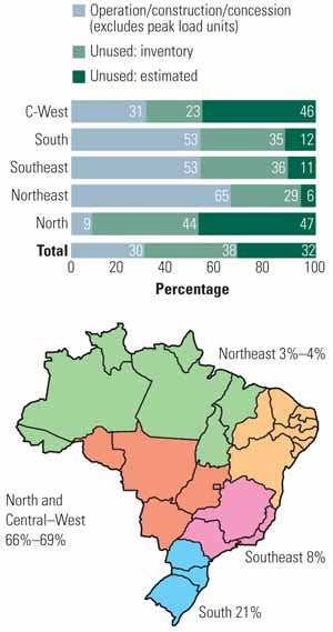

3. Brazil’s hydropower potential.
The EPE (Empresa de Pesquisa Energética), Brazil’s Energy Research Office, estimated in 2008 that the nation had two-thirds as much unused hydropower potential as what it was already using. Source: EPE
