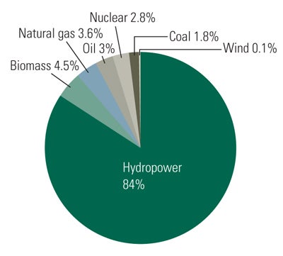

2. Brazil’s generation profile (2008).
Renewable hydro resources provide the vast majority of Brazil’s power, but those resources are also vulnerable to drought. Courtesy: EPE
