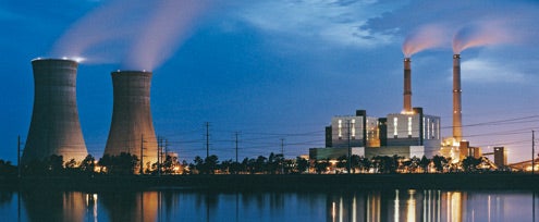

Orlando Utilities Commission’s (OUC’s) Stanton Energy Center (SEC), located about 13 miles southeast of Orlando, features two 450-MW coal-fired plants and a 656-MW natural gas–fired combined-cycle plant (Figure 1). SEC has elected to fire spot market fuels with an extremely wide variation in quality over the past few years while attempting to maintain historic levels of plant reliability.
1. Fuel flexibility required. The Orlando Utilities Commission (OUC), Florida’s second-largest municipal utility, owns the two coal-fired plants at the Stanton Energy Center (SEC), commissioned in 1987 and 1996. A consortium of OUC, Southern Company, Florida Municipal Power Agency, and Kissimmee Utility Authority developed a third, gas-fired combined-cycle plant. SEC is a zero-water-discharge facility using about 10 million gallons of water a day from a nearby wastewater treatment plant. Courtesy: Orlando Utilities Commission
