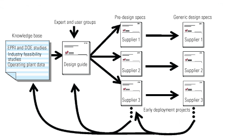

To date, the process has produced four types of documents and databases that are used both progressively and for feeding back lessons learned into their predecessor documents (Figure 2).
2. Design for success. The CoalFleet for Tomorrow program produces a series of design guides and specifications that are progressively more detailed. Early experience with the specifications is fed back and captured in later editions of the documents. Source: EPRI
