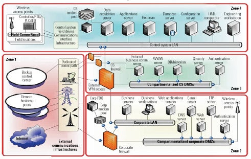

The opening up of plant systems has blurred the distinction between them and corporate information systems. Watching a plant engineer use a cell phone or PDA to call up a plant’s performance data and real-time operating parameters drives home the point. The “lines of communication” are now many and varied (see figure) and therefore vulnerable to intruders.
In the zone. Cyber security experts recommend dividing up the “meta organization” into zones requiring different protection schemes. Source: Trent Nelson, “Cyber Security—Who Needs It?” Idaho National Laboratory, Department of Homeland Security (April 18, 2007)

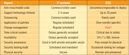

  • The realm of plant automation and control is clashing head-on with that of corporate IT (see table). Digital systems may advance rapidly, but they become obsolete just as quickly. Each new technology paradigm, such as the “smart grid,” potentially adds another level of vulnerability.

IT systems and plant distributed control systems (DCS) treat aspects of cyber security very differently. Source: Trent Nelson, “Cyber Security—Who Needs It?” Idaho National Laboratory, Department of Homeland Security (April 18, 2007)
