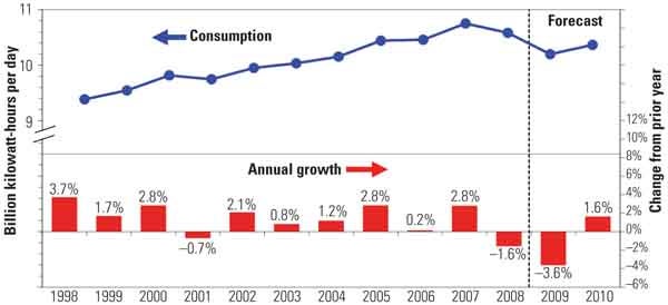

4. Electricity growth resumes in 2010. After a two-year contracting market, total electricity consumption in the U.S. in 2010 is expected to increase. Source: EIA, November 2009 Short-Term Energy Outlook

The need for new generation to supply load appears less urgent than in previous years. According to the EIA, demand for electricity has fallen since the economy tanked in 2008. The demand down-tick is the first since the EIA has accumulated these statistics, when it was created in 1977.
Facing a sluggish economy, consumers have lowered thermostats, cut off air conditioning, and dialed down appliances, leading to the decline in electricity demand. A cool 2009 summer in most of the U.S. helped to reduce air conditioning load. Net electric generation dropped 6.8% from June 2008 to June 2009. That was the 11th consecutive month that electric generation slid downward, compared to the same month in the prior year.
Analysts say they expect the declining demand trend to reverse when economic growth shows up at the beginning of 2010 or thereabouts. But they have been wrong before and may be wrong again. The EIA, the U.S. Department of Energy’s statistical agency, says it suspects the decline in demand will continue into early 2010, despite what appears to be a bottoming-out of the recession.
