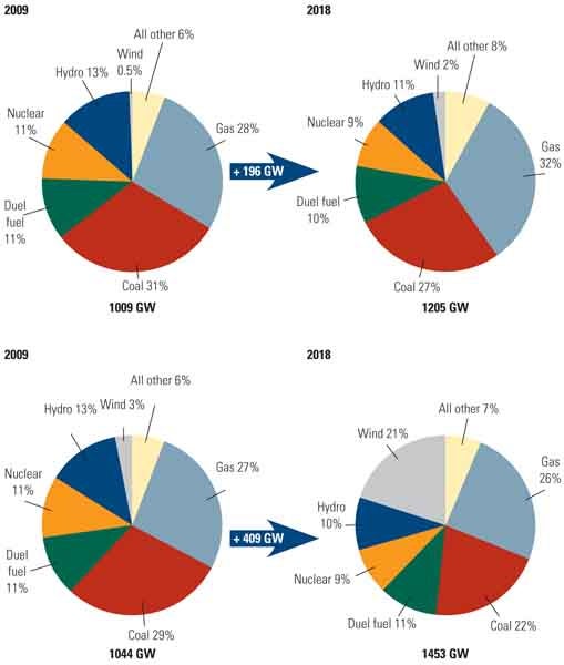

This overabundance of natural gas reserves may also have a downside, according to a report released by NERC on October 29. NERC’s "2009 Long-Term Reliability Assessment 2009 – 2018" notes that natural gas – fired on-peak power production may push past coal-fired generation by 2011, portending system reliability problems. NERC also cited cyber-security concerns, the integration of fast-growing renewable resources into the grid, and uncertainties created by the economic slowdown as emerging reliability worries that it faces (Figure 2).
2. Demand for electricity will rise in 2010. The top pie charts describe the expected growth of capacity that will be available during peak hours. The bottom pair describe the expected growth of installed capacity. Coal and gas will continue to be the fuels of choice during peak generating hours. Wind generation will continue to grow faster than any other type but will contribute little to peak supplies. Source: NERC

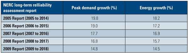

"These competitive advantages have resulted in an overwhelming preference for [gas] over the ten-year period, as installed natural gas capacity is projected to increase 38 percent over the ten-year period, while coal is projected to increase by only 6 percent," NERC’s assessment said. Its predictions of demand for new generation have been overly generous in the past but now appear to be more realistic (see table). The EIA predictions of electricity demand growth do not include peak demand growth as a separate category, but rather predict energy consumption will grow 8.2% through 2018. Together, the NERC and EIA data clearly show that the need for additional, dispatchable load during on-peak hours will be a primary focus for electricity system planners. Expect more gas-fired reciprocating engine and combined-cycle plants designed for intermediate peaking service to be announced in the coming year.
Electricity use increases, slowly. The North American Electric Reliability Corp. (NERC) expects the rate of peak demand and energy consumption growth to slow in coming years. Source: NERC

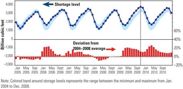

Increased gas demand this past summer already put a strain on existing gas transmission infrastructure. Chesapeake Energy Corp. admitted that it briefly slowed production because natural gas pipelines and gathering systems were already operating at maximum capacity (Figure 3).
3. Gas storage and pipelines full in 2010.
An excess of natural gas is packing gas lines and storage facilities. Shown is the predicted rate of natural gas storage for 2010 compared to historic amounts. Source: EIA November 2009 Short-Term Energy Outlook
