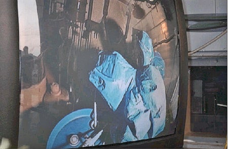

4. No reruns. Television cameras can be used to monitor high-hazard waste operations remotely. In this photo, two workers wearing Level A personal protective equipment are transferring hydrofluoric acid into a container for disposal. Courtesy: WESKEM LLC
