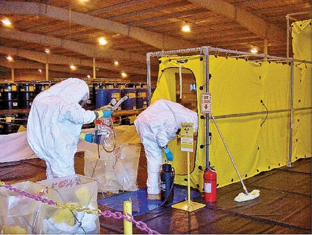

3. Protect your investment. Containment structures are used to prevent the dispersion of airborne chemical and radioactive contamination to employees, the building, and the environment. Courtesy: WESKEM LLC
