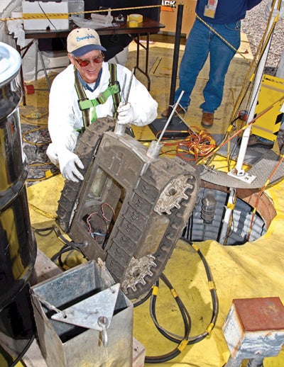

2. Metal, not men. Swarmy the robot recently completed its cleanup assignment—removing the last drum-full of thick sludge from the bottom of a deeply buried storage tank at Sandia National Laboratories. The 47-year-old tank's shape, depth, and position made cleanup efforts difficult. Its low-oxygen, confined-space environment precluded manned entry and inspection. Courtesy: Sandia National Laboratories
