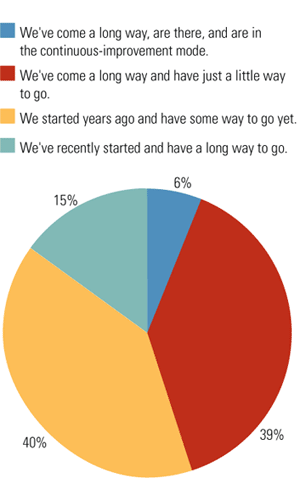

One question asked of the study population was, "What statement best characterizes your plant's journey to maintenance excellence?" The responses (Figure 4) clearly indicate that we remain our own worst critics when it comes to reporting progress at the plant level. Nonetheless, self-criticism can be useful—as motivation for striving to do the best job possible with the resources available.
4. How respondents describe their plant's journey to maintenance excellence. Source: EUCG
