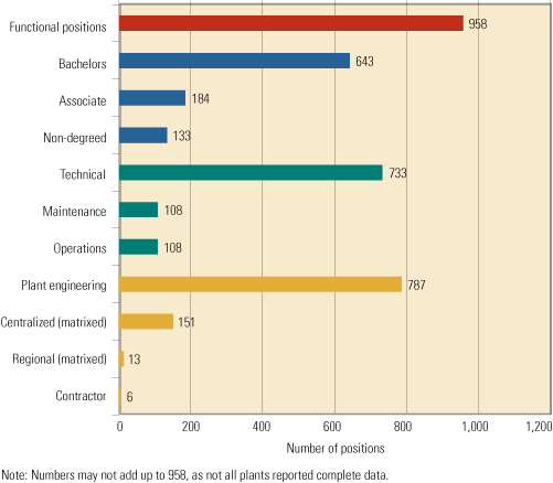

At their 62 plants, respondents reported a total of 1,034 full-time equivalent (FTE) positions on plant engineering and/or technical staff. Of those FTEs, there were actually 958 functional positions. Figure 1 breaks down that number in each of three categories: the staffer's education, his or her department, and the type of organization to which the staffer belongs. As one might expect, close to two-thirds of the E&T positions are held by engineers with four-year degrees.
1. Functional engineering and technical positions by education (blue), department (green), and organizational type (yellow). Source: EUCG

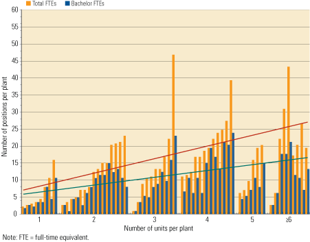

2. Staff size and education vs. plant unit count. Source: EUCG

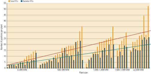

3. Staff size and education vs. plant size. Source: EUCG
