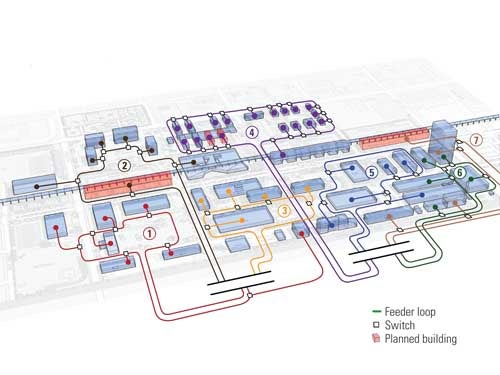

IIT’s PPS is modeled after the "High Reliability Distribution System" (HRDS) developed and implemented by S&C Electric for the University of California at Santa Barbara. The team divided the IIT campus into logical groups of buildings that will form electricity and thermal loops to maximize reliability and efficiency. The HRDS leverages a continuously energized loop feeder concept, which provides a redundant supply of electricity to designated campus buildings (Figure 5). Both feeds will be energized and will supply electricity to designated buildings. They will also be capable of carrying the entire building load. In addition, feeder redundancy will allow the rerouting of power to buildings in the event of a distribution feed fault.
5. The perfect number. The IIT High Reliability Distribution System divides the campus
into seven independently controlled and redundantly supplied management zones. Siegel Hall
is the far right building in zone 3. Source: Michael Meiners, Galvin Electricity Initiative
This approach was based on the team modeling projected loads on campus based on expected increases in enrollment and planned construction of new and recommissioned campus buildings. Transformers will be upgraded where necessary, and new 15-kV cables will be installed to provide additional flexibility. The result will be a robust feeder network that will give IIT the option of eliminating the existing above-ground ComEd transformers that step down ComEd distribution voltage of 12.46 kV to the switchgear rating of 4,160 V.

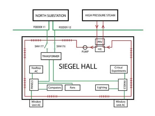

Siegel Hall, a research lab, is a good example of specific infrastructure upgrades that will mesh with the PPS technology. Siegel Hall’s distribution system consisted of two 4,160-V feeds from the North Substation (Figure 6). Feeders 12 (primary) and 11 (secondary) provided feeder redundancy through manual switches 176 and 177, respectively, which fed into a 500-kVA transformer where power was stepped down to 240 V. Typically, two panels on each of the three floors distributed electricity to lights, fans, and computers. A high-pressure campus steam system supplies heating to the building.

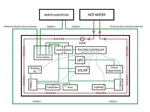

Figure 6 also provides an overview of Siegel Hall’s future Building Integrated Energy System. The PPS upgrades include a redundant electricity supply, efficient hot and chilled water supply, uninterruptible power source and/or generation, renewable energy sources, and an advanced building control system.
6. A world of difference. Each building will have a number of energy system retrofits completed. For example, these diagrams show Siegel Hall’s distribution system before (top) and after (bottom) the planned Perfect Power System upgrades. Source: Michael Meiners, Galvin Electricity Initiative
