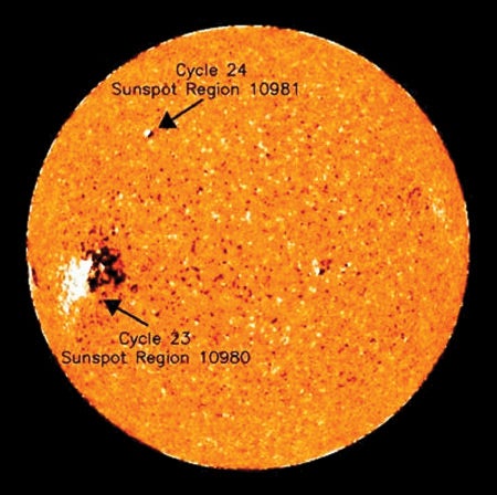

National Oceanic and Atmospheric Administration (NOAA) scientists have reported that a new 11-year cycle of heightened solar activity showed signs of beginning when the cycle's first sunspot appeared in the sun's Northern Hemisphere. Increased solar activity increases risks for power grids; critical military, civilian, and airline communications; GPS signals; and even cell phones and ATM transactions.
“This sunspot is like the first robin of spring,” said solar physicist Douglas Biesecker of NOAA’s Space Weather Prediction Center (SWPC). “In this case, it’s an early omen of solar storms that will gradually increase over the next few years.” SWPC is the nation’s first alert for solar activity and its effects on Earth.
A sunspot is an area of highly organized magnetic activity on the surface of the sun. The new 11-year cycle, called Solar Cycle 24, is expected to build gradually. The number of sunspots and solar storms is expected to reach a maximum by 2011 or 2012, though devastating storms can occur at any time (Figure 7).
7. See spot run.
The first official sunspot belonging to the new Solar Cycle 24 is shown in the northeast quadrant of Earth's sun. The large sunspot region just south of the equator is part of the waning Solar Cycle 23. Source: NOAA
During a solar storm, highly charged material ejected from the sun may head toward Earth, where it can bring down power grids, disrupt critical communications, and threaten astronauts with harmful radiation. Storms can also knock out commercial communications satellites and swamp GPS signals. Routine activities such as talking on a cell phone or getting money from an ATM machine could suddenly halt over a large part of the globe.
The new sunspot, identified as #10,981, is the latest visible spot to appear since NOAA began numbering them on January 5, 1972. Its high-latitude location at 27 degrees north, and its negative polarity leading to the right in the Northern Hemisphere are clear signs of a new solar cycle, according to NOAA experts. The first active regions and sunspots of a new solar cycle can emerge at high latitudes while those from the previous cycle continue to form closer to the equator.
