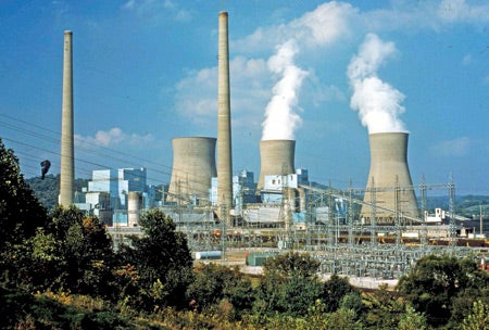

AEP's construction program will continue in 2008 as the company moves forward with work already in progress to install emissions-reduction equipment at three additional plants. AEP is installing scrubbers on three generating units at Amos Plant in St. Albans, W.Va. (Figure 5). It also has begun work on a third scrubber at Cardinal Plant and is installing a new scrubber, upgrading an existing scrubber, and installing an SCR system at the Conesville Plant in Conesville, Ohio. The Conesville Unit 6 scrubber upgrade will be completed in 2008. The new Conesville Unit 4 scrubber and SCR should be on-line in 2009. The Amos scrubbers will be completed in 2009 and 2010, and the third Cardinal scrubber will be operational in 2010.
5. Billions and billions. Scrubbers are being added to each of the three units at AEP's John E. Amos Plant in St. Albans, W.Va., as part of the utility's record-breaking investment in power plant environmental upgrades. Amos Units 1 and 2 are rated at 800 MW each; Unit 3 is a 1,300-MW unit. At a total of 2,900 MW, Amos Plant is the largest power plant on the AEP system and one of the largest in the country. Courtesy: AEP
