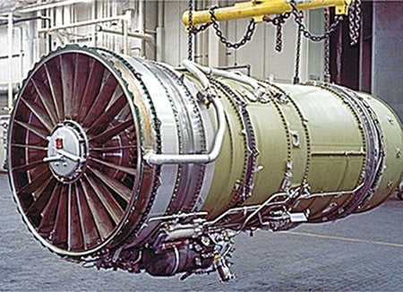

The FT8 (Figure 7) is derived from P&W's JT8D jet aircraft engine, a workhorse of the worldwide aviation fleet. More than 4,500 aircraft, or one-third of the global commercial fleet, are powered by the JT8D, according to P&W.
7. Like father, like son. This Pratt & Whitney JT8D aircraft engine, popular with airlines, is the forerunner of the FT8 Swiftpac for stationary power generation. Courtesy: Pratt & Whitney
The FT8 has been updated with technologies that can produce power with less noise and lower emissions and at a higher efficiency, says the company. The FT8 has been in production since 1991 and operates at more than 70 sites, with more than 300 units installed or on order. With a reported reliability of greater than 98%, the machines have accumulated more than 2 million hours of operation.
