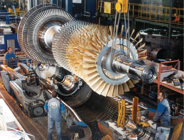

GE says that the project will capture, clean, and compress the blast furnace and coke oven gases generated during the steel-making process and feed it to GE’s giant 9E Heavy-Duty Gas Turbine (Figure 4)—a technology that will reportedly produce enough electricity to potentially turn an average-size steel mill into a net power generator.
4. From parasitic facility to utility. A GE project at the 170-MW power plant at Handan Iron & Steel’s mill in Handan City, China, promises to capture blast furnace and coke oven gases generated during steel manufacture and convert them into power. This image shows assembly of the massive GE 9E gas turbine. Courtesy: GE
