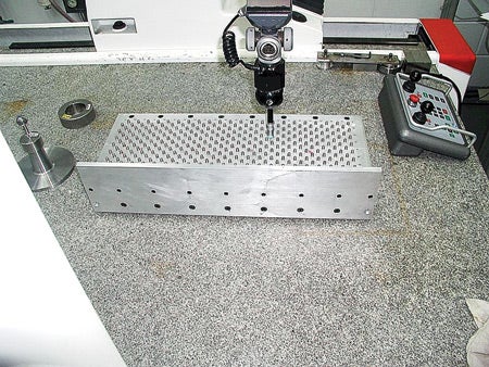

It's much easier to make accurate measurements in the shop, where conditions can be controlled. Inside, permanently mounted FARO arms or CMMs (coordinate measuring machines) can provide sub-mil accuracy. TurboCare uses a Mitutoyo/Metris stationary CMM equipped with both a ball probe and laser scanner to measure components such as rotating and stationary turbine blades and turbine carrier rings (Figure 2). "This is the preferred type of tool for designing and building components with maximum precision," says Siedzik. "But because CMMs only work in the shop, they can be used only on freestanding components that have been removed from the turbine."
2. Less than a thou. In the shop, a coordinate measuring machine can measure parts' dimensions with sub-mil accuracy. Courtesy: TurboCare
