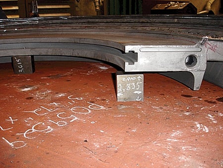

The second reason TurboCare doesn't rely on OEM information is that it may not reflect reality. For example, when project manager Joel Saenz opened up a 350-MW steam turbine to install a new rotor, he found that its eighth stage was displaced (Figure 1). It turned out that the "as-built" figures provided for the stage were just design specs, not actual measurements.
1. Out of shape. The deflection of this eighth-stage vane arc segment had to be measured before the assembly could be reengineered. Courtesy: TurboCare
"I looked at the readings from 1985 when the turbine was built, and every one was perfect. None was off by even a ten-thousandth of an inch," Saenz says. "No one has ever built a perfect machine. But based on those readings, you might conclude that this OEM had."
The third reason for taking measurements—both in the field and in the shop—prior to a retrofit is that wear and tear alters equipment clearances over time. Before designing new parts to raise turbine performance, you must quantify the condition of existing parts with great precision.
