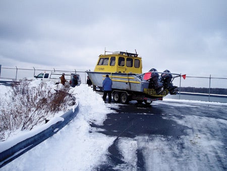

The inspection took three days—one day to set up and two days in the water. Although the access road had been cleared of snow earlier in the morning, it took more than an hour to haul the dive boat up to the reservoir, a trip that normally takes 20 minutes (Figure 5). Ice, and stopping to allow logging vehicles to pass, caused considerable delays. Once the crew arrived at the reservoir, they had to shovel snow from the steep access into the water.
5. Icebreaker. The dive boat with the sonar-equipped ROV had to pass over icy roads to reach the reservoir. Courtesy: FirstEnergy Corp.
It took more than four hours to set up the equipment. The first day ended with the dive boat being in the water for a 90-minute shakedown cruise. With below-freezing temperatures expected that night, the decision was made not to put the ROV in the water to check out its systems. There were just too many seals that could have frozen later if the vehicle had been "put up wet."
