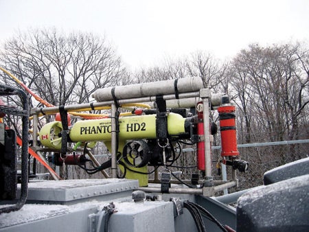

Despite these challenges, and the fact that a "wet" inspection of this size and complexity had never been done before at a FirstEnergy facility, Bill Harker— director of FirstEnergy's hydro and combustion turbine plants—gave Seneca Station's inspection team the go-ahead to investigate using an ROV (Figure 2). "Any time you have an opportunity to safely and cost-effectively shorten an outage by four days and still meet all of your inspection objectives, you have to thoroughly investigate the option," said Harker. "Over the past several years, we've had success using new techniques during planned maintenance outages of our hydro stations, and we hoped that we could add ROV inspections to the list."
2. The Phantom knows. The remotely operated vehicle used to inspect the upper reservoir of Seneca Station. Courtesy: ASI

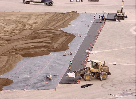

How did Harker determine that using an ROV would shorten the Seneca Station outage by four days? In 2004, some repair work had been done on the upper reservoir in a section known as the "Fluent Run Depression," a natural depression capable of holding 40 million gallons of water. As a result, even after the upper reservoir was drained, the Fluent Run Depression still contained a mixture of water and mud that took more than four days to pump out. After the water was removed, the six acres of the Fluent Run Depression were repaired by adding two layers of liner topped with 18 inches of sand and ground asphalt (Figure 3).

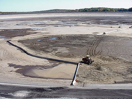

However, when the upper reservoir was refilled, the initial rush of water washed away some of the sand and ground asphalt. To eliminate further wave damage, "Jersey barriers"—shaped like the state—were installed around the Fluent Run Depression section and the refilling was completed successfully (Figure 4). All instrumentation readings and twice-weekly physical inspections showed that the repairs worked as planned. Even so, the section still needed to be included in the FERC Part 12 safety inspection for 2006.
