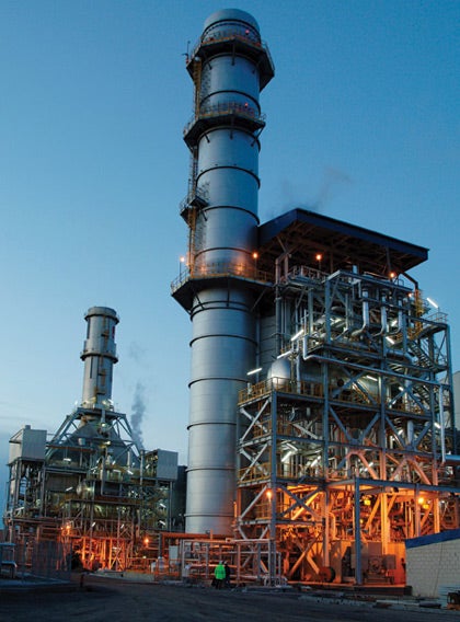

Castejon 2 (Figure 1) is powered by a single combined-cycle system that Alstom calls the KA26-1 because one of its two prime movers is the company’s GT26 gas turbine (GT). The other is an Alstom STF15c steam turbine—a floor-mounted, two-casing, reheat unit that shares a shaft with the gas turbine.
1. Overachiever. High availability and reliability, as well as predictable O&M costs, were key design requirements for Castejon 2. Courtesy: Alstom Power
The third major subsystem of the KA26-1 is a heat-recovery steam generator (HRSG) that links the two turbines in a conventional way. Hot exhaust gases leaving the gas turbine at over 1,100F fire the HRSG, a triple-pressure, natural circulation unit with a horizontal internal arrangement.

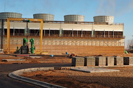

The final notable feature of Castejon 2’s design is an inlet fogging system that increases the GT26’s output by as much as 10 MW when ambient temperature is high and the plant requires additional cooling (Figure 2).
2. Versatile cooling system. Castejon 2’s cooling tower can operate either in wet mode or in hybrid (wet/dry) mode to eliminate troublesome plumes. Courtesy: Alstom Power
