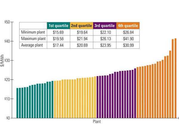

Here’s an example of the differences between data from the EUCG and the data source used by the NEI. The NEI nuclear plant operating data presented on its web site show that "production costs" (defined as all operating costs plus fuel) for the top quartile of plants, averaged for the period 2006 to 2008, were $16.1/MWh (1.61¢/kWh). The EUCG data, as reported directly from its members, average $17.44/MWh, as you’ll see in Figure 5 — about an 8% difference. The lesson learned here is to carefully consider the source of your data.

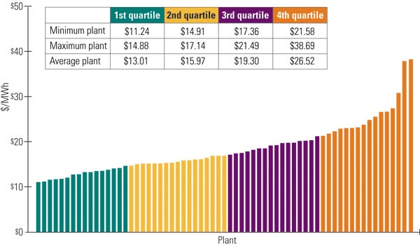

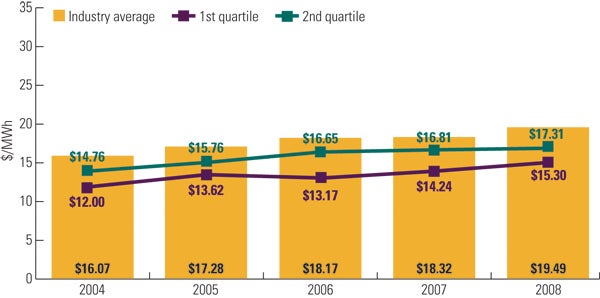

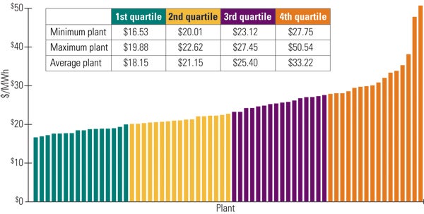

POWER made a series of queries of the NIID to obtain detailed production cost data. The three key queries were for 2008 data, industry average data for 2006 – 2008, and five-year industry data (2004 – 2008). Within each key query, detailed cost data were requested using standard EUCG definitions: operating costs (sum of plant, support, and other related costs), total operating costs (operating costs plus fuel), and total generating costs (total operating costs plus capital invested — normalizing the various capitalization policies among utilities) — all in $/MWh. The data from each query were then automatically formatted into benchmarking quartiles and bar charts. The results from these nine queries are presented in Figures 1 through 9.
1.    Operating costs for 2008. The EUCG defines “operating costs” as the sum of plant, support, and other related costs, without fuel or capital investment expenses. Note that the data are reported by each of the 65 nuclear plants in the U.S., not by individual units. Individual unit data are available to members of the EUCG Nuclear Committee. Source: EUCG

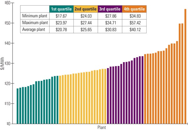

2.    Total operating costs for 2008. The EUCG defines “total operating costs” as the sum of operating costs plus fuel, but not capital investment expenses. The average cost of fuel for plants in each quartile can be found by subtracting Figure 1 data from that of Figure 2. Source: EUCG

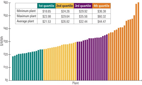

3.    Total generating costs for 2008. The EUCG defines “total generating costs” as the total operating costs plus capital investment expenses—a fully loaded cost. Source: EUCG

6.    Total generating costs, average for 2006–2008. Source: EUCG

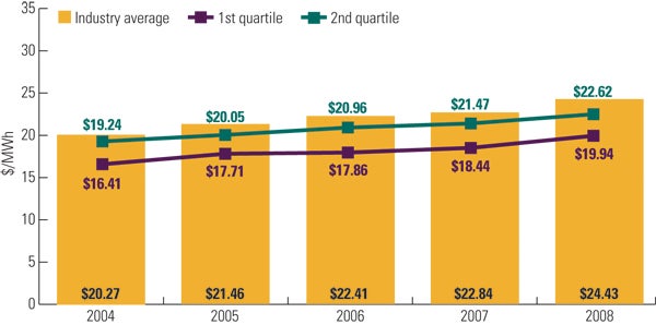

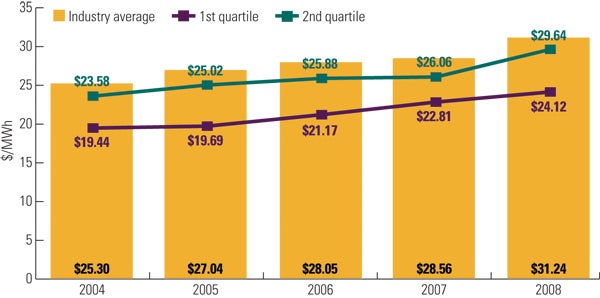

7.    Operating costs, industry annual average for 2004–2008. Source: EUCG
8.    Total operating costs, industry annual average 2004–2008. Source: EUCG
9.    Total generating costs, industry annual average for 2004–2008. Source: EUCG
