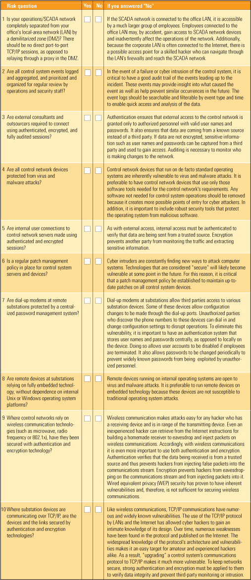

Are your control systems cyber safe? These are the top 10 questions that utility risk managers should be asking about the security of their IT and SCADA systems. Checking “no” for any item indicates that a more in-depth assessment of the utility’s security status is warranted. Source: Aegis Technologies Inc.
