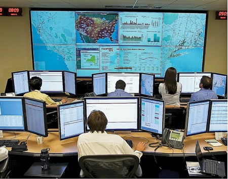

Tim Healy, EnerNOC’s chairman and CEO, is proud of the company’s accomplishments. When SDG&E calls an event, Healy’s team in Boston at EnerNOC’s Network Operations Center—the “NOC” in EnerNOC—springs into action (Figure 3). The NOC sends automated dispatch information to all designated facility managers informing them that their engines will be remotely fired within 2 minutes. NOC operators then initiate the event, which automatically notifies customers and remotely starts their generators. Within minutes, clean, permitted generators from numerous sites remove 25 MW of load from the grid and help SDG&E avoid blackouts and brownouts.
3. The “NOC” in EnerNOC. EnerNOC’s Network Operations Center in Boston is a state-of-the-art facility that can dispatch thousands of assets across the U.S. and Canada. The NOC is staffed 24/7/365—much like an ISO control room. Courtesy: EnerNOC
