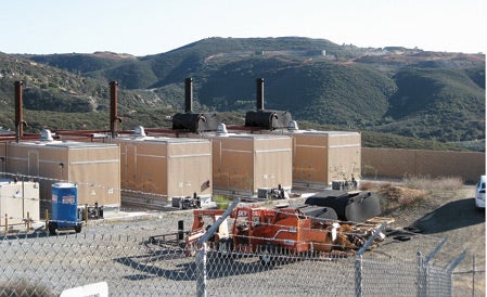

The San Diego County Water Authority’s (SDCWA’s) Olivenhain Dam facility in Escondido, Calif., also enrolled its four 2,000-kW Caterpillar diesel generators in the program (Figure 2). These generators, normally used to provide power to the facility’s three 2,500-hp water pumps in the event of a power failure, are the perfect fit for the program: they’re big, powerful, and willing to work. They are also set up in parallel with the grid, so there is no interruption if a program event is called or the grid blacks out.
2. Mighty generators. In this construction photo of Olivenhain Dam’s four 2,000-kW Caterpillar diesel generators, the two generators on the right have the new filters installed; the gensets on the left are awaiting the upgrade. Courtesy: EnerNOC
